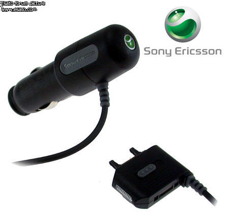

jcwhite_uk
Joined: Feb 18, 2004
Posted: 2006-02-23 10:19
the genuine car charger has a through port so you can plug in headphones as well.

Posted: 2006-02-23 10:54
yep, that's the one I use.
fastport stacker? Now that'd be useful. Sorta like a usb hub

Posted: 2006-02-23 11:12
max_wedge
Xperia Neo Black
Joined: Aug 29, 2004
From: Australia
Posted: 2006-02-23 11:47
one of those and a standard charger could be modded together to make a desk charger with a pass through port.
