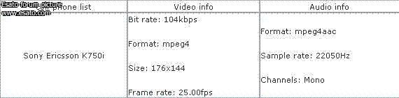

hi, i'm trying to get some video clips/movies on my memory stick to play on my k750. but i'm having problems with some being very laggy/freezing, sound going off etc. basically i looking for the settings to convert a video for my phone, playing from the memory stick at the best possible quality i can get but still with a perfect playback so that no lag takes place and sound doesn't go. i found this on th web:
it plays absolutley great off the the memory stick, the only problem i have is that the quality is very very poor, and isn't too far off from being 3gp...
any help, thanx

The problems is is that the resolution is smaller than the screen size, although this cant be helped it causes a small quality loss because the video has to be stretched. IMO you should up the bit rate a little and drop the frames to about 12-15 fps.

what do you think for the bit rate?

Not 100% sure, best bet would be to mess around with different settings, I only used about 120 on my P910, but people have used alot more, its down to your own prefrence. Start at about 160 and see how it plays.

yea, thanks... with ur advice it worked perfectly, thanks a lot.
