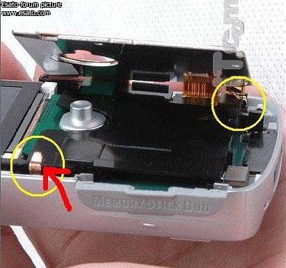

at the end every body lived in happiness and peace
after checking the phone i found the problem
one of the clips was dislocated as shown in the pic ,
i solve the problem but i still don't know why a ground line of keypad will cause such a thing with the screen
i hope this will work with u
