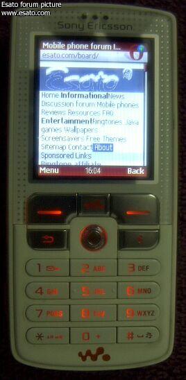

seguy
Joined: Dec 21, 2005
Posts: 85
From: Central United States
Posted: 2006-01-13 23:00
Here's a couple of pix of the setup screens I'm talking about :

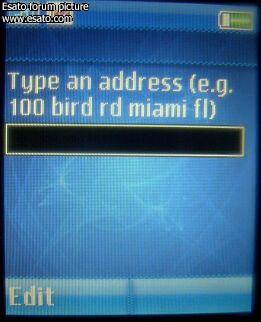

I also use the Google maps application. It is wonderful. The only problem with it is that when getting driving directions, I can enter the starting address, but when putting in the destination address, there is no way to confirm (the "more" dosen't show up above the right soft key), thus I have to exit the program at that point. So driving directions are not possible.
Could you confirm the absence of the "more" above the right soft key when entering a destination address?
Maybe this is a problem with the program? Thanks!

I occasionally get that error too. I think it is a bug in the software probably isolated to SE only. There is a workaround that I have found to work for me. When you get to that point where you need to confirm but do not have the menu to do so, simple press and hold the back button until the menu for Exit and Minimize appear. Press the down on the joy stick so that the Minimize item is highlighted. At this point, there should be an extra Info label on the right soft key. Press and release (do not hold) the back button now and the screen should go back to the application but now the More label should appear on the right soft key thus allowing you to confirm the text entry!!!

Thanks for the tip slugger! It works great!
