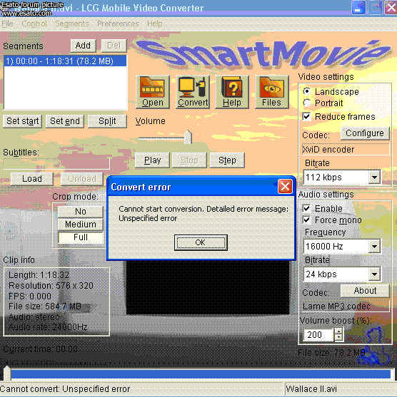

Recently when I try to convert some movies I get the following error:
Previously I had no problems but all of a sudden, this happens. The fully thing is the error message only happens of some movies. I can't work out which ones, though, in terms of file formar/codec etc.
Can anyone help

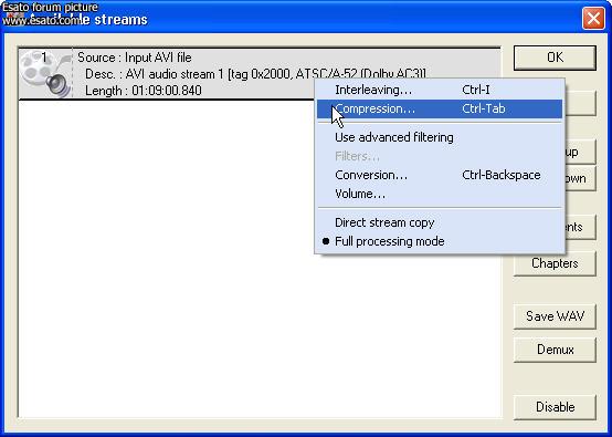

numb
Joined: Feb 07, 2005
Posted: 2005-11-12 16:54
oki Your screenshot shows that it is indeed AC3 audio
Heres the step by step guide
1. open the sourcevideo in VDubMod:
2. from the menu select streams, streamlist:
3. rightclick on the stream and select "full processing mode"
4. rightclick again on the stream and select "compression"
5. Select the Audio compression, when done click ok
6. From the menu select video, and select "direct stream copy"
7. From the menu select "save as", and give the new file a new name
Thats it, your done and now have a new video where the audiopart is converted to mp3, and the video is kept in original quality.

Thanks for your guide. However, it didn't work. See the following screenshots after using VirtualDub Mod (I called the file Wallace II):
And there's one of the file info:
One thing that I found was that I didn't have the same selection of mpeg-3 options, your was 160kBits/s 48,000hz 20KB/s my best was 56kBits/s 24,000hz 7KB/s. I don't know if thats the probelm why it did not work.

To get more mp3 encoding selections you have to use the mp3 filter from windows mediaplayer 10 and do a litle registry hack to use it as proffesional filter - see more about that here:
http://www.looprecorder.de/tut_l3codec.php
Back to smartmovie, if it still complaints like that, then I cant help.
Your converted file looks fine, the lower bitrate mp3 should not be a problem and the xvid codec shouldent be a problem either.
You could try installing a different playback filter for mp4 - like the latest divx version, but it seems that its just smartmovie which is somehow busted or at least extremely picky about which files it will accept. From that my best suggestion would be to use a different conversion software than smartmovie, cause from the looks of it, smartmovie doesnt seem all that smart
According to the info on smartmovies website it supports directshow filters, so everything you have tried since we started should have worked in smartmovie. Perhaps you need to either reinstall the smartmovie converter or upgrade to a newer version.

I have done the looprecorder and now i have the full list of compressions as shown on your screenshot. So I thought I'll have another go. I stopped the convertion after about 3mins and then started up smartmovie and it loaded so I pressed convert and it started to convert. Yippeeeeeeeee!
However, the sound quality has deteriorated. I will pm you if I can send an attachment, if not, then is it possible that I could email you directly??
