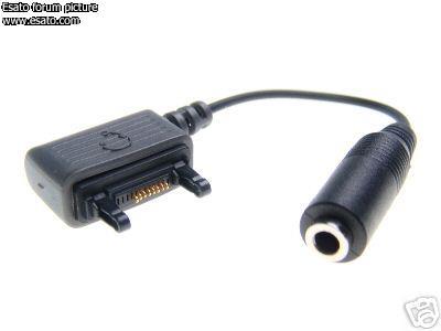

First, you must have an adapter like the one that comes with W800i package (hpm-70 adapter) or any 2.5mm stereo adapter (most have no built-in mic) like the one below.

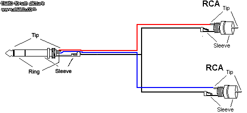

Then, secure (2) mtrs. stereo cable or any length you want, (1) 2.5mm stereo connector and (2) RCA jacks (red & black).
Below is a sample of metal 2.5mm stereo connector.
Then, connect/solder the 2.5mm stereo connector and 2 RCA jacks to the stereo cable at both ends as illustrated hereunder.
If you do not want to make it by yourself, this stereo cable connector is always available in the market. But its fun if you can invent it by yourself!

it's true it's cheaper to buy a 3.5mm adapter but the mmc-60 isn't very expensive anyway, and much better audio quality. Also, handmade cables are okay if you have good soldering skills, but if you are a beginner I wouldn't recommend making your own.
Besides, you can actually buy 3.5mm to rca cables ready made for cheaper than the components you'd need to buy to make your own so by the time you make your own cable and buy an adapter, you could have bought the mmc-60 and have change left over.
