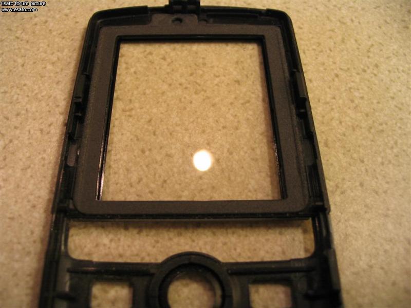

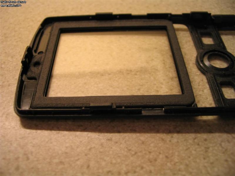

numb
Joined: Feb 07, 2005
Posted: 2005-10-23 21:16
I just took my frontcover off in less than 5 minuttes, and took 2 pictures showing the foam/rubber sealant
