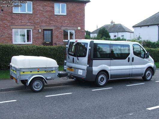

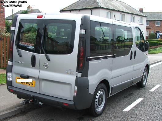

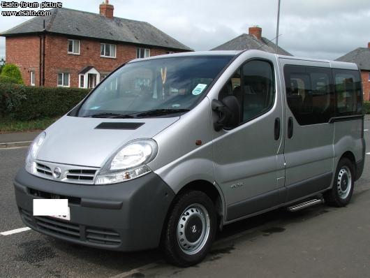

I have fitted lots of kits, mainly to my own cars, just removed a BT nokia kit, as it is useless, and fitted it to a mates car, and another one to his mums car, and have fitted several SE kits to cars I have owned, but never used this music mute before, as I have never had cars which it would fit. On average it takes me about two hours to fit a kit, and that is a proper install, not a make do one. i will have to get the removal keys, for the radio, off the dealer, and have a look and see what connectors it has. here are some pics of my new motor, so you know what car it is.

Nice van mate, a bit of Renault DNA showing there I see.
Shame we don't get that model down here.

It is a Renault in reality, even has Renault on the rear door glass. Engine is Renault as is the gearbox, in fact the whole van is built by Renault in france, and Vauxhall have one the same, called the Vivaro. The main difference is price, as mine is about £2000 cheaper than the Vauxhall, and about £1000 cheaper than the Renault.

Actually the vivaro, traffic and nissan are made in luton by a company called IBC using renault engines. The factory is right next door to the vauxhall factory and used to make the frontera. I know the vivaro uses a vauxhall radio, but dont know about the others.
