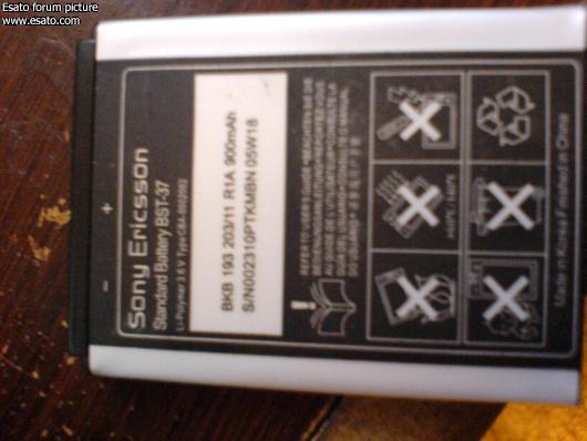

@Yellow-Snow
I cant tell the reason that battery is dead from the picture is because there a serial number missing of the bottom left right hanside corner...
