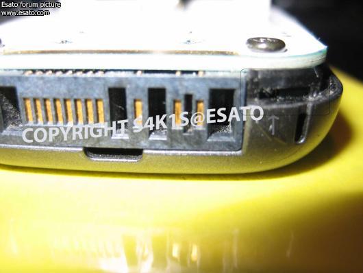

Step 1: Open the cover @ the top
Step 2: Open it @the sides
S4k1s Joined: Mar 09, 2005 Posts: > 500 From: Sweden PM |
When u put the cover back you have to attach it from the low side first!

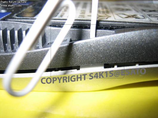

how do you get the clips on the side off? |
agsuriya Joined: Mar 30, 2006 Posts: 15 PM |

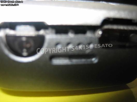

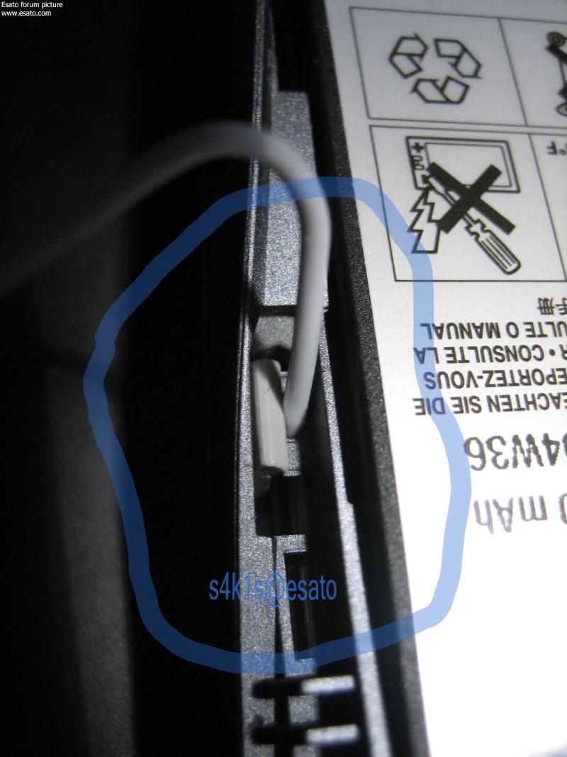

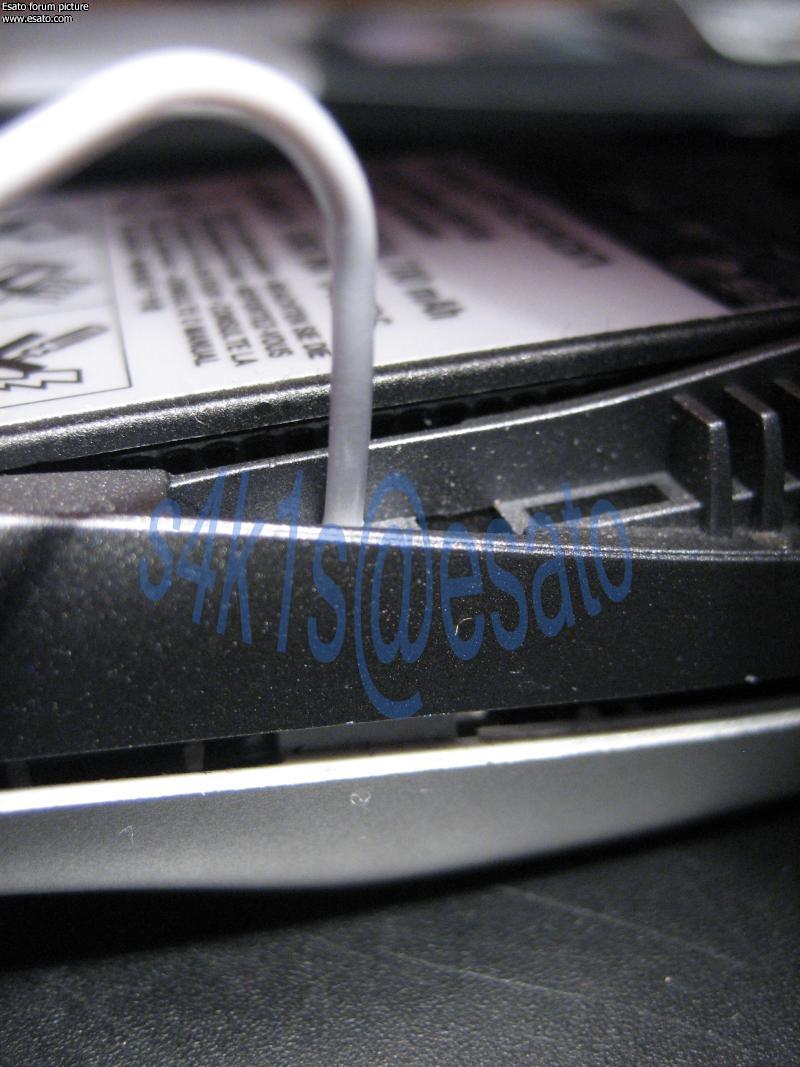

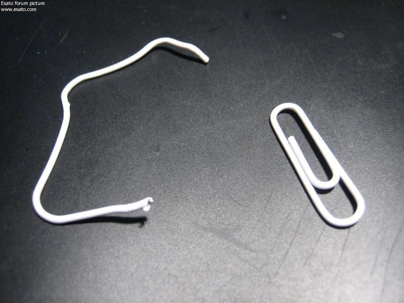

Hi torque_tonic,
The sideclips can be released by using a pointed paperclip or needle.
Note: At the centre beneath the sideclips, there is a semi-hole. If you keep pressing the paperclip through this semi-hole, the sideclips get ejected.
Regards,
agsuriya

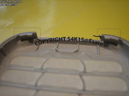

hi, i have a k500i and i was just wondering if taking off the casing should be the same because the side clips on mine dont seem to want to click. It looks like the bit between the back and the front (the black bit) is stopping them, any suggestions or help? |

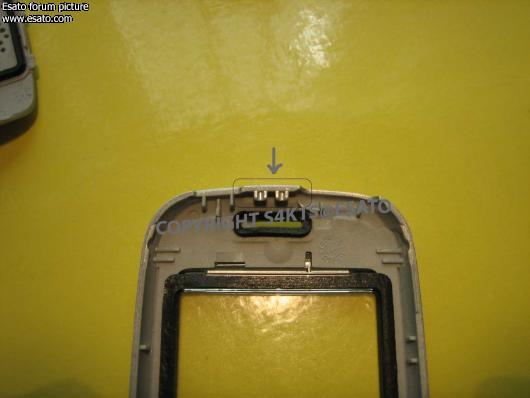

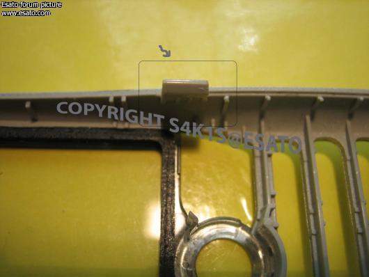

You'll have to pull and push a bit ...
I hope these additional pics help you ...
In step 2
