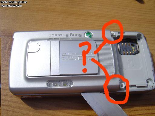

I got a new housing for my k750i and the housing came with a T-series screwdriver.
This screwdriver can undo the screws on the outer edge but how do I remove the screws shown in the photo?
Normal small-headed screwdrivers dont seem to fit.
Any suggestions? |

i think you need a special one t6 i think
You need a T6 torx screwdriver.
You can buy them from electrical or electronic parts places.
For example, in the UK, i bought mine from Maplin.

Anyway, a correction on my previous post. The two screws on my K750i are simple flat headed screws, not torx, so a normal screwdriver would remove mine easily, such as a spectacle screwdriver.

The 2 screws that hold the back cover onto the centre section are small + shaped (phillips/pozi drive). As Etaab mentions. Specticle screwdrivers would remove those.
The 2 that are in the battery compartment are torx screws. The torx screws hold the bottom of the front cover to the centre section.
Both my K750 and W800 screws are the same way as stated above.

i got a allen key which opens the phones, t6 screw drivers are rubbish and round off to quick. |
