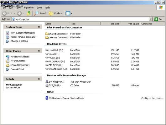

hey guys, just an update..
well none of the other devices are reseting my pc.. i have a memory stick.. mp3 player and a camera... i can hot plug them in and out all day!.. the computer is quite happy.. i have 4 usb ports... 2 are on the mobo and 2 have there own connectors on the mobo...
also i have tryed plugging the k750 in and out of my other pc.. and it works fine.. i did it about 20 times... each time it loads up the memory stick just fine...
so im realy not sure now what it is now..
im thinking the configuation of my drives???
ps this is only 2 hard disks .. with partitions.. LOL
