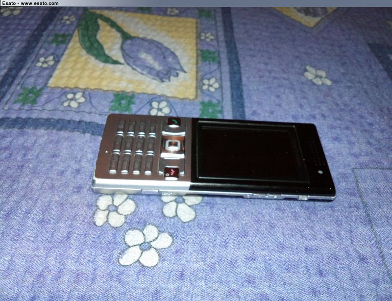

 | @Raiderski Here are some pictures out of focus:
 I would add that in all cases the phone indicated that focusing is well done. I saw that during focusing process the camera gone through the right focus point, and it stopped later, and was focused to a closer distance -except the sports mode in the following cases. So when taking a picture you can see during focusing that something is wrong... only sports mode confirms that the software isn't well optimised, and the hardware should be ok.
 Auto mode:
 Document mode: (You can see in the lower right corner, that area is in focus -it is because is closer to the camera which focuses to a closer distance.)

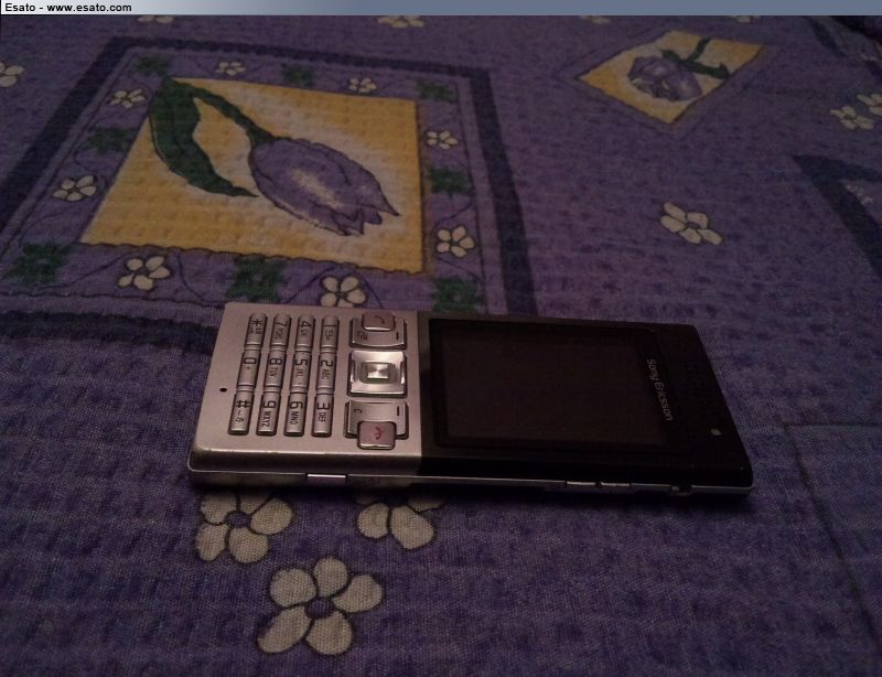

 Sports mode: (I would say focusing is perfect)

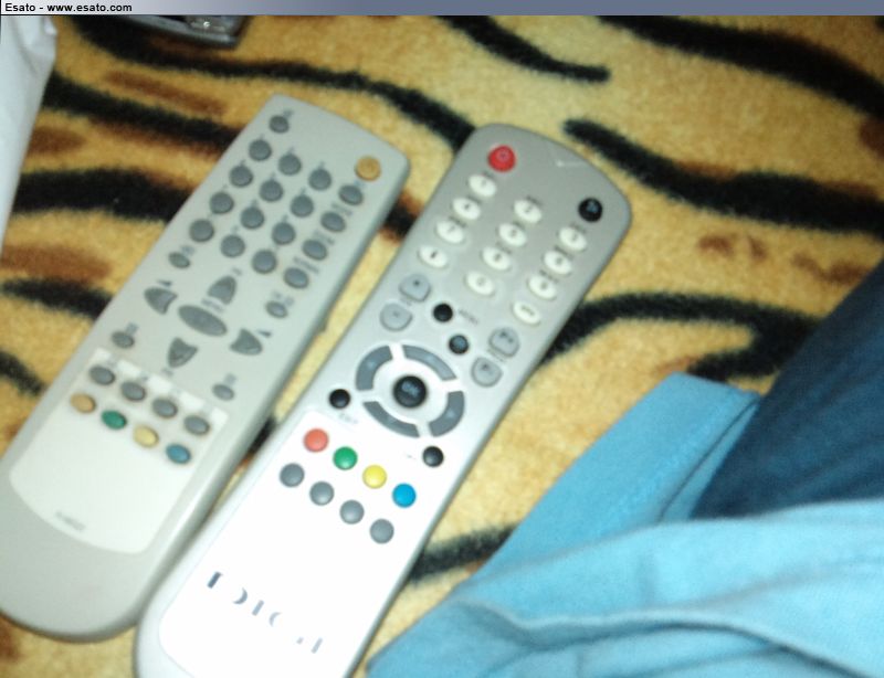

 Another pictures:
 Auto mode: (You can see that the lower part of the picture -that is closer- is in focus.)
 Sports mode: (Precise focusing)
 In the previous situations I could try many times, the results were almost the same. But as I said the succes of focusing highly depends on the actual situation. So the sports mode isn't perfect but in most situations performs the best. In spite of these sometimes even in daylight is nearly impossible to take a well focused picture on a medium distance (0.5 - 3m). After the sports mode sometimes the document mode helps, but many times the only soultion is the infinite mode.
