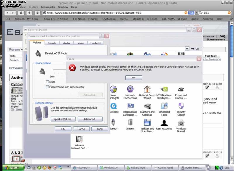

Now my fekking sound isn't working on my desktop, System restore isn't sorting it out either.
Aparantly Windows Volume control hasn't been installed :S
Is there a way to get it on without a fresh install?

I'd start by uninstalling the sound driver and installing the latest version from the PC / Motherboard manufacturers website.
It may have become corrupted.
If that doesn't work, you can try a repair reinstall. To do this, stick your Windows XP disk as if you were going to do a fresh install (don't worry, you're not!)
When it starts up, proceed as you would normally. DO NOT select the repair console when prompted, but carry on as if you were doing a fresh install.
You should be prompted with the option to perform a repair reinstall. You won't lose any of your personal data or applications, but you may need to reinstall some of your drivers afterwards.
It's still a good idea to back up all of your important stuff beforehand though, just incase something goes wrong and the PC won't boot afterwards. It's very rare that this happens though
By the way, this option isn't always available if your PC came with a restore disk, it depends on how heavily modified the restore disk is.
