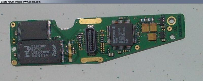

Can Sb tell me what is this PCB? i found in an SH888. i know in the S868 there is nothing under the cover only the connector. i search for the type:
sxk 107 6507 and for the type of the cpu: rop1011078 but nothing useable.

the hardware-modem

And what happen, if i dont put back to sh888, or put in to an s868 or i888?
And with this fancy modem im able to surf on the net(rs232) with amazing 9600b/s?
nice:)

Yes, by removing the modem you downgrade your SH888 to a S868. Both phones have identical boards and firmware. Put the modem interface into a S868 and it will work.
Even the IRDA-receiver is on a S868 board though there is no IRDA window in the front cover. The only further difference between both phones is that you need a small firmware patch for S868 to enable the IRDA menu.
