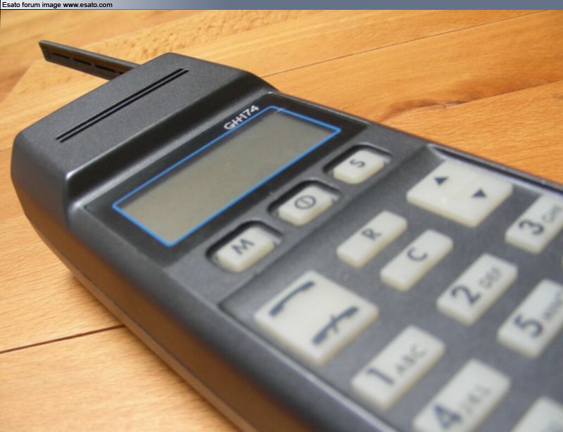

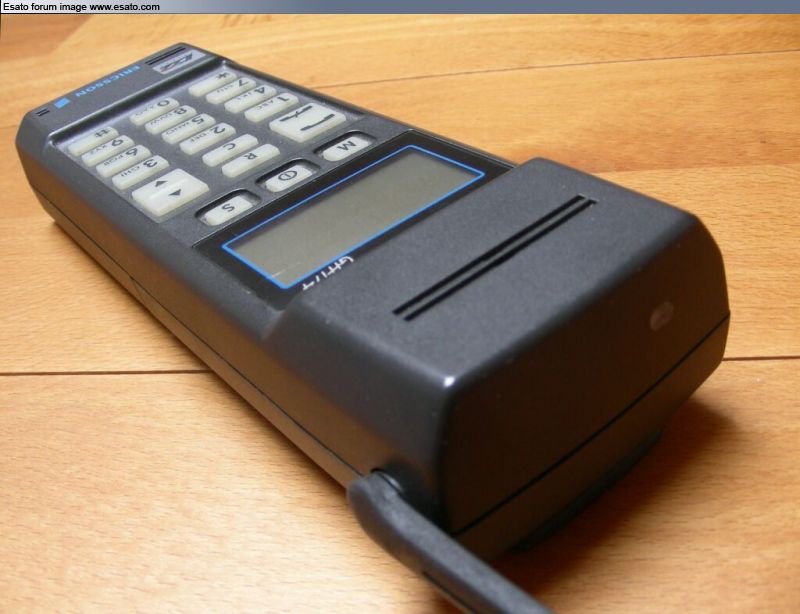

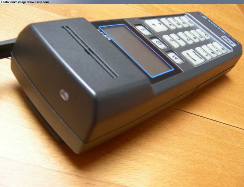

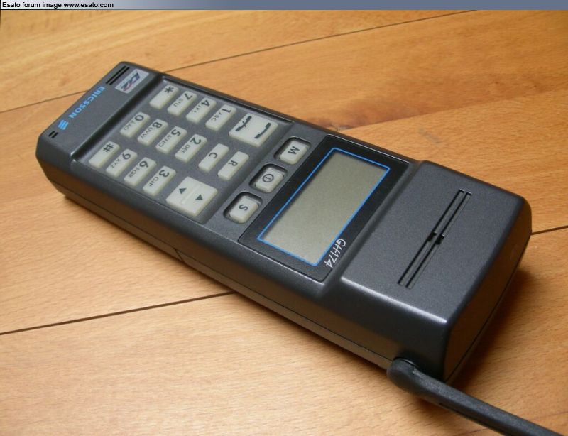

Hello there,
here is my GH174, came back from revision today, works perfectly....I went out with it, you should have seen the face of the people passing by....I put the phone on the table of a coffee shop......

Posted: 2008-04-15 01:30
the M and S buttons what are for? are a sort of send and end buttons?

On 2008-04-11 15:11:00, bucheral wrote:
Hello there,
I have the same phone and also works well. Probably I have to try the same as you did
PS. As I remember the battery is original, so for now it lasts maybe only one day when no much talking.
