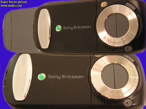

I have just received a black housing from www.djfinn.co.uk... via ebay....
http://search.ebay.co.uk/s700[....]opagenumZ1QQcoentrypageZsearch
They have silver, black and deep blue... for £7.45...
The black casing is made from black ABS.... so no paint to scratch....it is matt black and not glossy...but looks good... casing fit is good.... although there are a couple of details inside the case like location pins that are not present but the bits of the phone that need them are fixed in with double sided tape and are secured in the new case...
You need a jewellers screwdriver set.... £3 from Halfords or other retailers that sell them
Unfortunately....no chrome ring....but I have emailed them to see if they can source them...
At the min...waiting for an answer...but it is sunday....
Overall very please with it.... A little daunting at first... I used the japanese link pics as a guide that are elsewhere on this forum....
If anyone a little daunted by doing this... If the trust is there... I would gladly do it for you for a nominal fee plus post and packaging

Must say after a week..very very pleased with it...no creaks...
The only thing....it does not have the Sony Ericsson script on the new screen or on the battery cover.....
I used the original screen......which is held on with double sided tape.....
Quite easy to do....as long as you put the screws back in the same locations....
There are 3 different size screws....and the screws that hold the rotating brackets are the smallest..... Good luck....

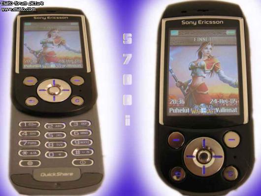

I bought some housings from ebay,one black and one "original looking".Not kidding you,i spent about 5 hours taking my s700i apart . After i got it disassembled i lost one of the microscopic springs from the microphone,after a while i lost the other one too.
That i got fixed after i replaced them with two slightly bigger ones.After i had got everything together again i noticed the swivel didn't work as it used to,because of thois the camera just kept telling me to close the phone or quit cameramode .I couldn't figure out why...at first.After a while i noticed the new housing didnt have two of the metal parts that the originals had,one was the bit in the upper part,has something to do with the speaker,and the other part is a small metal piece that is the part that reacts when you open/use the swivel action.
Some other things i noticed:
The memcard sticks with the new housing.
The logo looks just crap (on the battery cover,see picture),the Quick share sticker was alright,the screen was just awfull,the borders that are supposed to be black,was darkblue and not very well made at all.
So there are some things to consider if you want to try this.And a big minus is that the warranty flyes out the window after this.
