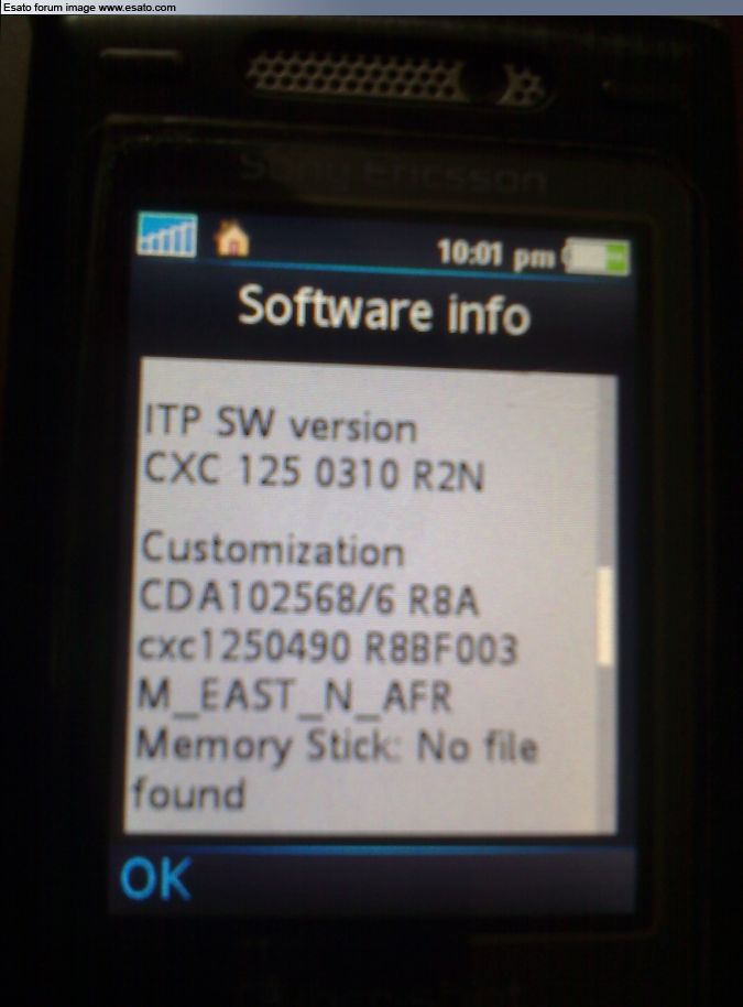

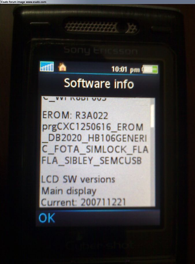

mechexpert Joined: Jun 26, 2008 Posts: 142 From: PUNJAB(IN) PM |
heyy ppl m damn confused ..
this is wt i did ..
i downloaded main firmware (i.e. K800_R8BF003_MAIN_GENERIC_WI_RED53.mbn)
stp 2 = using "mkrest" for making your rest with drag your Main Firmware (*.mbn) into it.
done .. using above file rt >?
stp 3 = using "qamaker" for making quick accsess patch with drag your Main Firmware into it.
done using same main firmware file.
stp 4 , 5 , 6, 7 , 8 , 9 , 10 , 11 no prob .. done !!
stp 12 = flashed .. done !!
stp 13 , 14 done !!
but problem is .... my fone won't start
den i flashed again using main it started .. follow d steps but it wont start again .. den again flashed main .. its workin but same as before
pls tell me where i went wrong ??
& ya i haven't used d cust pack or fs file anywhere really confused where 2 used it & didn't really fine one on d internet for CID 53 (mine is CDA102568/6 R8A
cxc1250490 R8BF003 M_EAST_N_AFR )
help me ppl ...
thankz !!
Junz Joined: Jul 31, 2008 Posts: > 500 From: INA PM |
go for bflash again, and then flashing your main firmware again, after that QAP. if the problem still happen, reflashing your main+Fs from Oflash in db2020 script.  |
