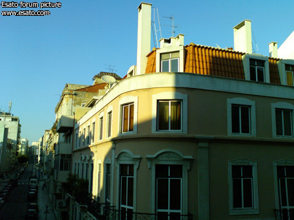

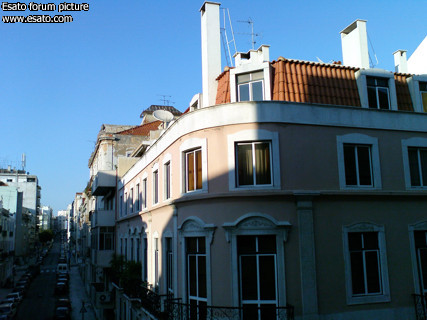

 | It seems I've found the bug on the P1 camera => it's on the White Balance settings.
 Photo with *automatic* white balance (correct colors):
 Same location now with *Natural Light* white balance (wrong colors)
 The building is *PINK* not yellow!!
 So, the trick is:
 => To avoid taking pictures with the wrong white balance, DON'T use the Natural Light.
 => If the camera even in Auto, shows the wrong colors, go to the settings and choose a different White balance manualy.
 That's a nasty bug...

 | What do you mean "bug"? Of course the colors will be wrong if the white balance is wrong... If "auto" doesn't chose what seems right to you, you'll have to decide yourself what works best.
| _LAU_ Joined: Sep 10, 2004
 From: Zeta Reticuli Phones:.P1;.P910
 | It's a bug because the Natural Light is the same as Day Light (the case)... unless someone proves me wrong. |
| jabbadabba Joined: Oct 15, 2007
 Posts: 31
 | "Daylight" has many different temperatures. There's no one setting that will fit all.
