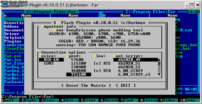

whatsucka
Joined: Feb 17, 2007
Posted: 2007-08-24 19:44
thanx rockygali
wat should i select after installing the plugin??
all i see is this
Posted: 2007-08-24 19:50
db2020_49 for CID49 phones
db2020_51 for CID51 phones
db2020_52 for CID52 phones
hope it helps.
