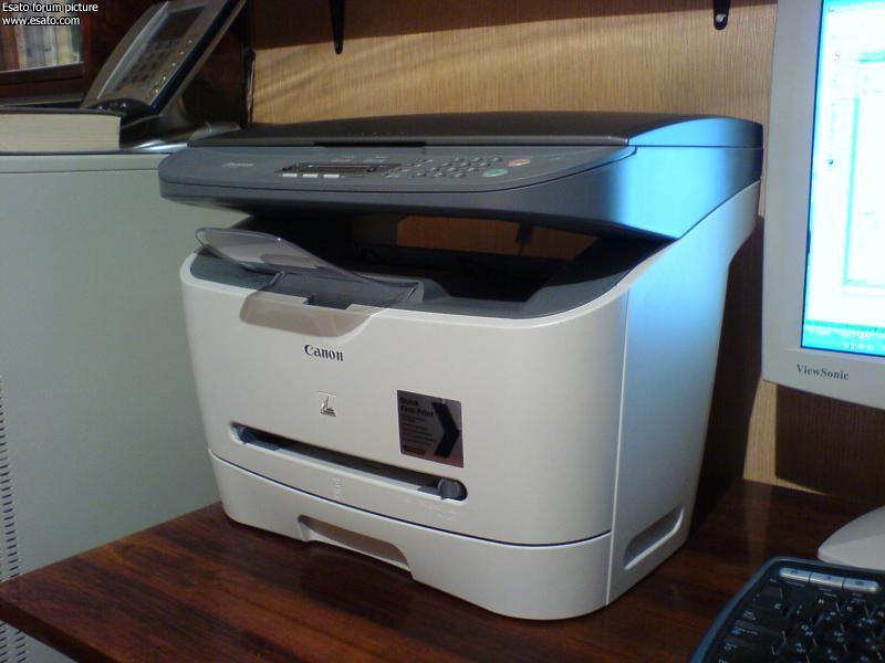

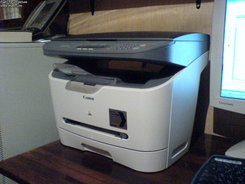

SPU Joined: Feb 07, 2007 Posts: 131 From: Russia, SPb PM |
Two shots of my printer (indoor, one 100Watt bulb), tungsten WB:
Normal mode (day) = slow shot:
Results: ISO 100, exposure 1/4 s
Night mode = fast shot:
Results: ISO 800, exposure 1/40 s
