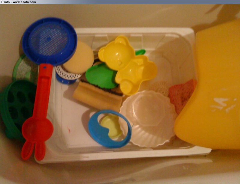

Can someone help me what is wrong with my phone (link to my report with a color balance comparisson), or photo skills with my ELM? I do not seem to get the right setting for any light condition at all - see photos
with flash:
It was not a grey day - actually the sun was shining:
without flash - notice how much more disturbing are my lines
As I can see there is something seriously wrong with my ELM - what do you think?
P. S. my lens is clean + settings are normally on automatic, anyway also other settings do not give a good result.

There is nothing wrong with your Elm... this is a problem with every Elm, it takes very poor photos in low light/indoors with those horrible lines everywhere.

The indoor lighting photos are as expected for the Elm... I think your indoor lighting is much lower than you expected, causing a high exposure time. I can see motion blur (the kid) as well as the light bleeding from the TV. You can't expect this cell phone camera to be as good as your SLR . It's also possible your lens is dirty/dusty from the first blurry photo.

I have said this before to get rid of the lines in low light reduce the exposure by about 2. This makes the lines vanish and the overall night shot not really much darker. They are noise or colour lines for some reason Sony Ericsson has not dealt with this in an update. Maybe they cannot I do not know. I have not noticed these lines in Hazel.

I agree with bono, and it seems on the lowlight indoor shots you did, you increased the ev, this makes the lines appear very visible and irritating. But other than that, the color balance on your indoor shots looks ok.
