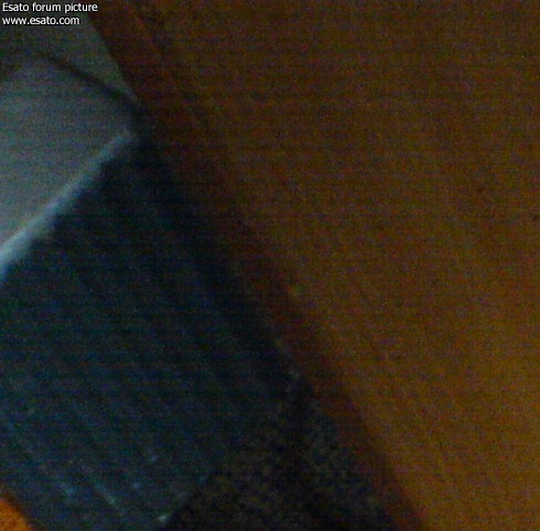

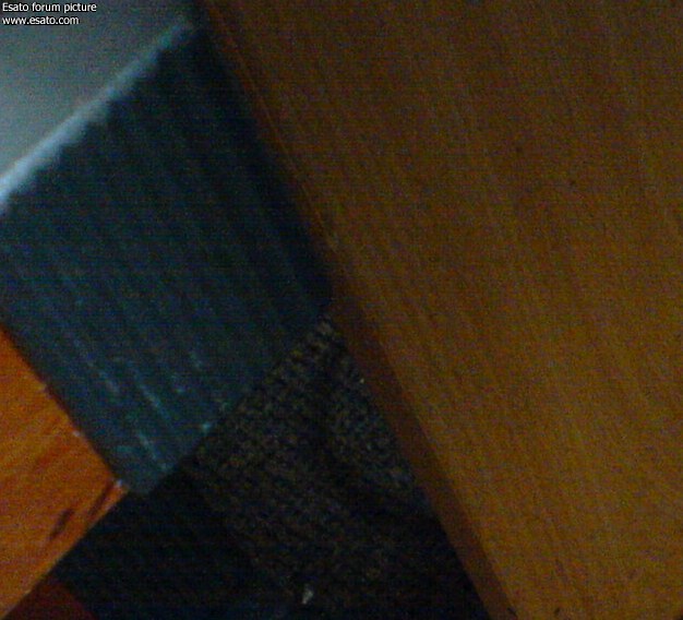

Bellow are 2 crops from serial pictures. 1-st AF mode EM, 2-nd - Macro-ON, MF, EM, but sorry EM_RATIO=3a (i like fast shooting )
1-st ISO=800, exposure 1/20
2- nd ISO=320 exposure 1/8
Pay attention at noise level. I guess it should be more noise on 1-st snap, but it is vice versa. I check it several times.

EXIF ISO issue...
no issue. this is happening only if you change EM ratio value to something else than 40. the same is on 21.92, so i guess it's on every driver with EM
EXIF ISO issue fixed in 6.7.1u was completely different thing

ISO800 was mistake only, very easy to reproduce in EXIF for sure this value in real was lower than 320 (something similar is on 2nd pic). as i wrote before this faulty EXIF description is possible only when EM ratio is changed in code
BTW: EM code changes done by leetiran with small modification can be quite good solution for 679. final result is ISO160 pic but with half exposure time of original EM code
