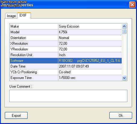

@all: how can I find out what driver was used for taking a photo with the K750i? I have several pictures with extraordinary quality, but at least we do not know what driver was used some months ago... Any idea thar could help???
kind regards,
Randolph
Sombra
Joined: Mar 28, 2007
Posts: 165
From: Brazil
Posted: 2007-11-15 00:50
@Randolph
All digital cameras and some camera phones save images with Exif file, which possess advanced informations over photo taked.
Many programs this can be see in properties of image, but also is possible open this informations in file properties of Windows/Linux.
See below the Exif informations with PhotoFiltre software:
In Software field you can know the version of camdriver used, for K750i, observe last digits, in this case, correspond to Strong's SuperFunction 5.6.
Sorry for my poor english.
