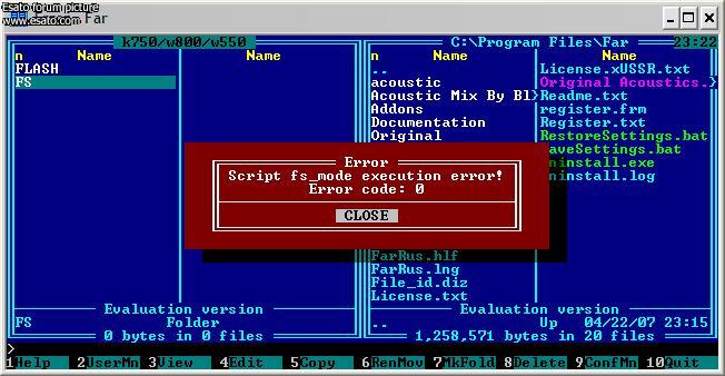

i cant get w600 driver out, when i use FAR too go in the flash of my w600 i get this error
strizlow800
G900 Brown
Joined: Aug 23, 2006
From: Macedonia, Skopje
Posted: 2007-04-23 13:19
W600 is CID49 and cannot be opened with FAR like that. You need to use the CID49 plugin and the phone xs++ loader to get into it's filesystem, or another 3rd party software to have a copy of your drivers.
