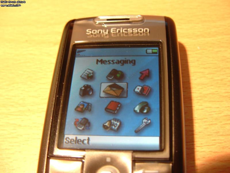

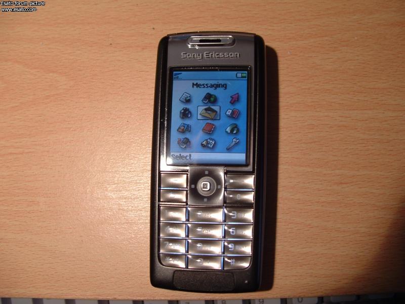

Also, didn't post any pics of the fixed T630, so here we go:

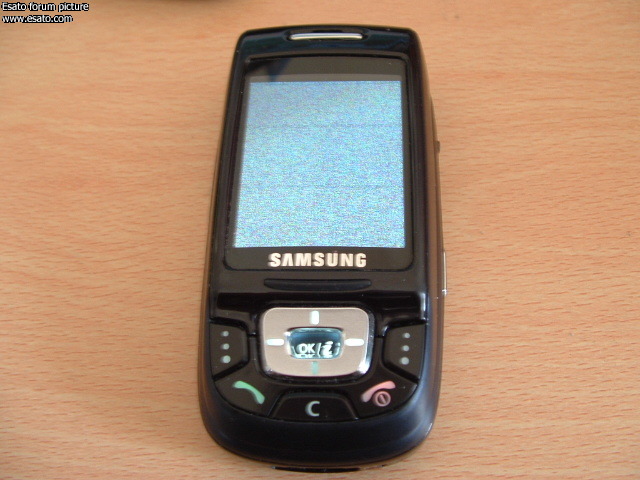

Well, the next phone in my experiment arrived today, a D500! It came boxed with instructions and charger, so no need to have to buy any more accessories for it. As the listing described, the screen is rather fuzzy:
Am just about to take the phone apart, I'm hoping that the ribbon cable (which should be the problem) just needs a good clean, and it's connectors needing a good clean and will work fine. Fingers crossed!
I've come to what could be my first snag. Taken the phone apart, had a fiddle with the data ribbon and put the phone back together. Turned the phone on, screen was working! Great! Started going through the menus, and all was fine except the backlight was flickering. Screen wasn't scrambling, just the backlight. So, I took the phone apart again, took both ends out of the ribbon cable, gave them a clean and put the phone back together. I also had a look at the camera connection as the camera seemed to be out of focus too, and a photo and video I found on the phone also seemed to be out of focus.
Put it all back together, turned the phone on, and now the backlight on the screen barely works at all, and the camera isn't booting up at all! I seem to have managed to make the phone worse
I'm hoping it's just the ribbon cable that's at fault, though I couldn't find any nicks or tears in it. Might try buying one, which will add a tenner to the cost at least, and it may not fix all the problems - the camera unit could be at fault. At least the phone makes/recieves calls, the mainboard seems to be fine (unless the ribbon connector on it is a fault, which I'm hoping not!)

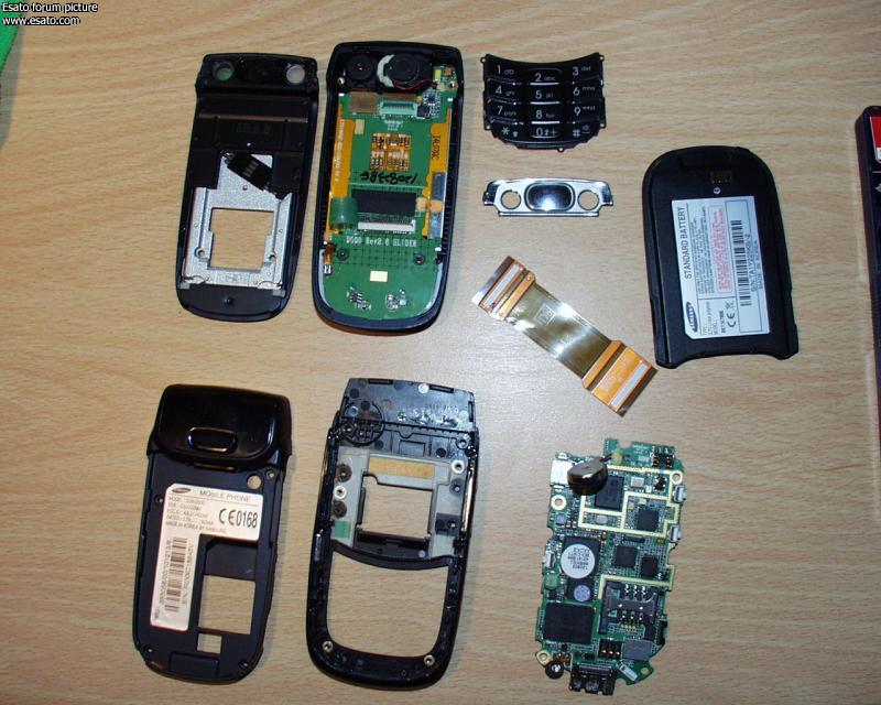

I've had slightly mixed results. Took me a while to get the ribbon in place, despite it being described as a genuine ribbon it seems to be shorter than the one I've just replaced, so it was a bit tricky to put in. I also slightly damaged the connector on the PCB, so was expecting the worst when I put the phone back together and powered it on.
But I was surprised to find it seems to be fully working! Backlight now working, all keys functioning great! Though have two problems still. The camera now works, but is still fuzzy. I suspect the plastic cover on over the lens is either non-genuine or has become discoloured, I might try removing this to see if it makes any difference.
The other problem, perhaps more serious is as the ribbon is shorter, or perhaps me doing something slightly wrong is that the phone does not close quite flush. The slide works fine, activating the screen when slid up and locking the keypad when slid down, it just doesn't slide fully down, it's just a millimetre or two off shutting fully.
I think I'll have to sell the phone as being slightly faulty still, I should get my money back, perhaps make a small profit, but might give Samsung phones a wide berth in future as taking 'em apart and those ribbon cables are a pain in the @rse!
Oh, and if anyone's interested in what a dissected D500 looks like here's a picture:
