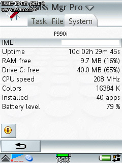

21d 10h 52mins ... 11.6mb free w/ SMP ...  |

12 Days 10 hours had to restart due having 4% ram Swissman couldn't free it up  |

Actually, 7d 21m 40s, 6.7Mb (11%). Not too much free ram, maybe because I've the Free SMan...
