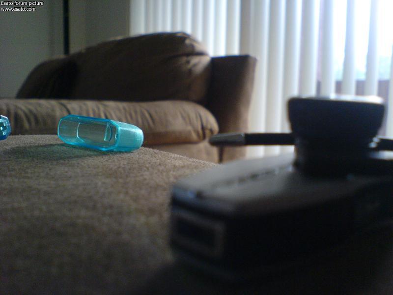

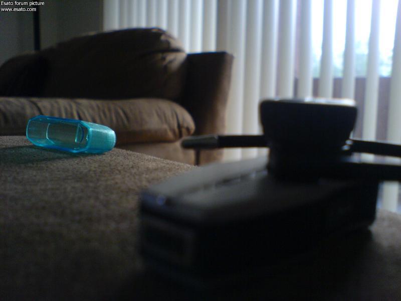

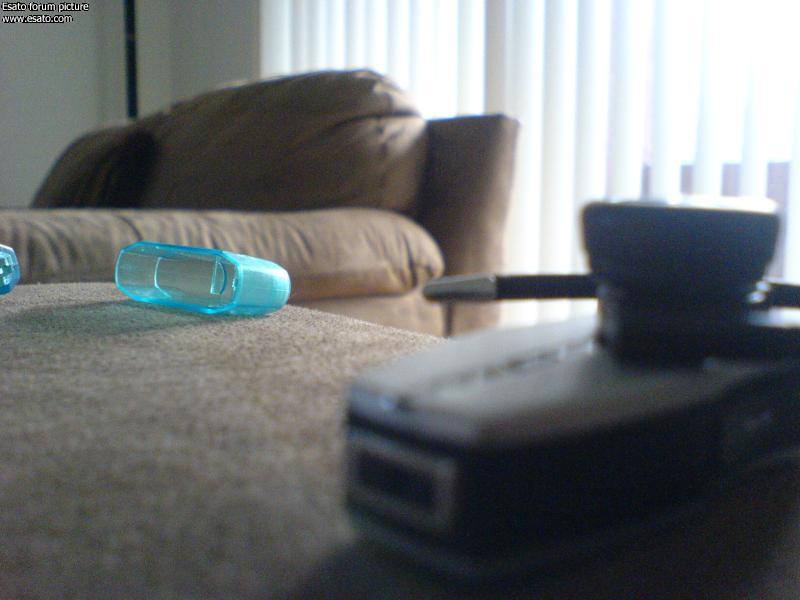

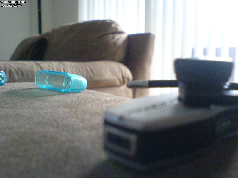

you've discovered something very very interesting! you may have just found how to control ISO, at least with Raider's driver. all shots below are with Raider's 6.6 driver. i manually set shutter to 1/13s and i manually set EV to zoom 2.0. look at the results of series of shots below ... each increase of EV resulted in an increase in ISO. did this many times. same result each time. i think we have found how to control ISO!
Setting EV anything lower than 2.0, resulted in ISO 80 shot since the w810 can't set ISO lower than 80.
shot 1: shutter 1/13s, EV 2.0 = ISO 80
shot 2: shutter 1/13s, EV 2.1 = ISO 100
shot 3: shutter 1/13s, EV 2.2 = ISO 125
shot 4: shutter 1/13s, EV 2.3 = ISO 160
shot 5: shutter 1/13s, EV 2.4 = ISO 200
shot 6: shutter 1/13s, EV 2.5 = ISO 160 - my error went down instead of up
shot 7: shutter 1/13s, EV 2.6 = ISO 320
shot 8: shutter 1/13s, EV 2.7 = ISO 400
shot 9: shutter 1/13s, EV 2.8 = ISO 500
