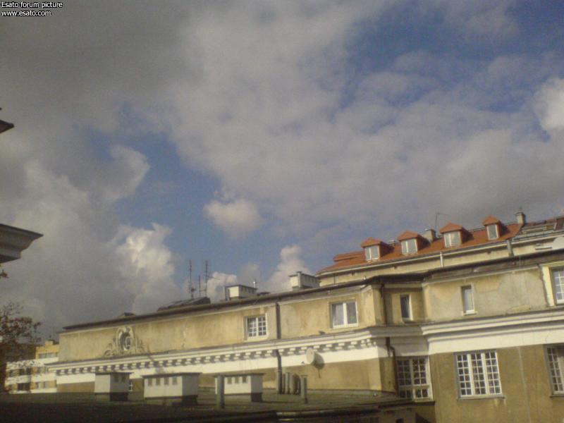

@Ridersky
Original PIC1 (Sharpness 6)
Free Image Hosting at <!-- BBCode auto-link start --><a href=www.ImageShack.us" />
Original PIC3 (Sharpness 0)
I'll disable EM for the next pictures, I wasn't aware that EM shouldn't be used with MXE-60.
