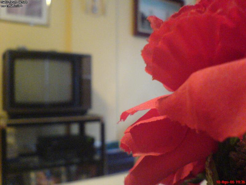

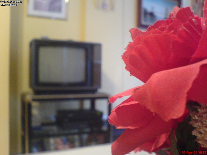

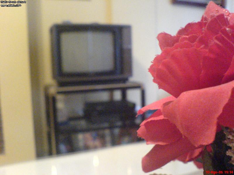

i've doing some test with 2.72 and 10.01, and here are the results, i've used macro and night mode on and off but no light, these are indoor photos with low ligth:
10.01 macro on, night off
10.01 macro on, night on
2.72 macro on, night off
2.72 macro on, night on
