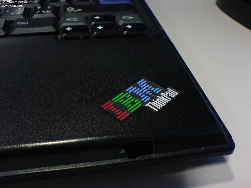

Untill now I dont have enough details ( maybe one or two people tested the driver for me )
here I have some shots for you ( random)
