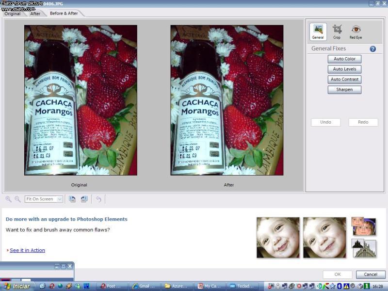

BTW
I think people are forgetting about this software that comes with K800
Photoshop Album Starter Edition
Very easy to use... perfect for people who don't know how to use photoshop. It's a starter edition, very simple to use!
Just what people here need...
