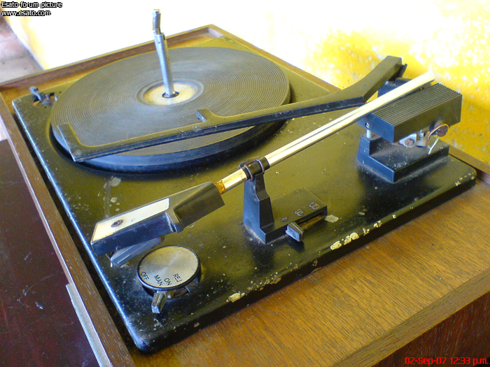

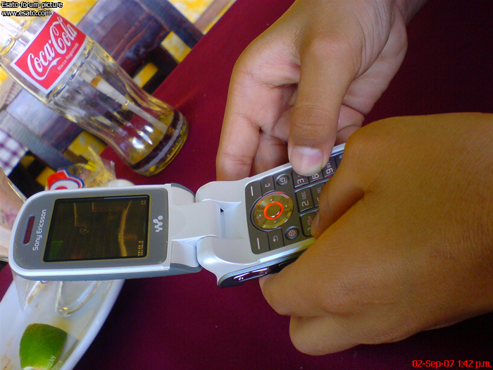

I wonder why I see so many blured pictures posted here, I don't have that problem with any driver.
A4A 7.8
