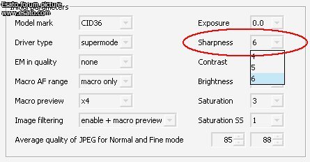

Coo|io
Joined: Nov 05, 2006
Posts: 51
From: somewere
Posted: 2007-09-03 09:29
@raider
help me a little bro...
how do i change the sharpness on cid 36,to 5 ?

Coo|io
W800 36 and blurry pics with sharpness = 6? even with very good light conditions? strange
load CID36 driver version and...
