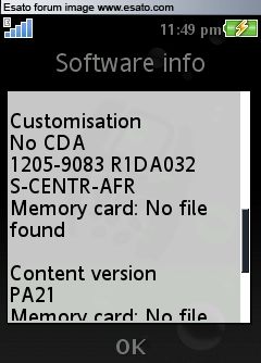

my c905 information :
i have smile shutter , way finder , tracker . also sms chat enable with customize_upgrade.xml
todey i reset my phone (master reset ) ,, youtube app lost , help !!!

You'll need to put the firmware on again. This is because the Youtube app was not protected and is therefore gone from the phone.
