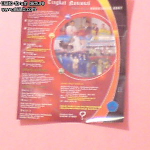

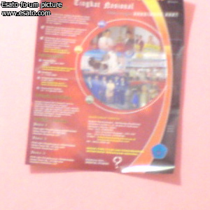

On 2007-09-01 08:30:05, VegaR wrote:
Result of some camdriver test to shoot a poster in my bedroom, object distance 3.5 m from camera. The picture was crop in photoshop without changing quality.
My camera k750-w800 R1BC002 CID49, Camera setting: Fine mode, macro on, no flash light, focus infinity.
A4A_7.8
Sarmad 5.8
SUPER_Modmix by Strong 1.1
Maybe this result is not absolute, so I don’t compare and have no comment.
[ This Message was edited by: VegaR on 2007-09-01 07:32 ]

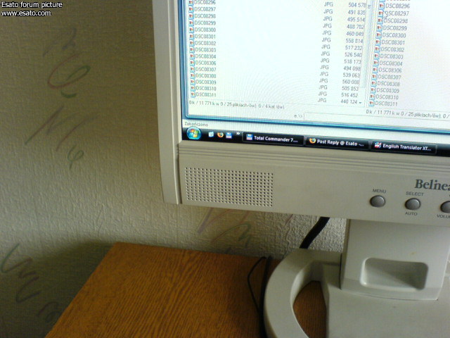

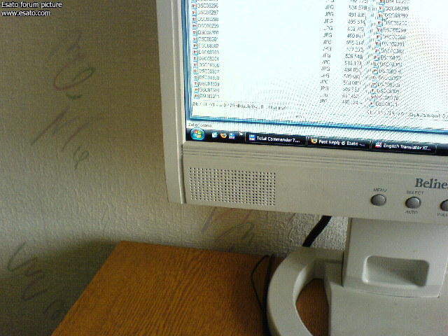

I don't know what are you talking abot. A4A sharpness is good
Distance 3.5 m, focus to infinity, all auto
Sarmad 5.8
Strong Mix 1.1
A4A 7.9
A4A 8.0 (compression like as in 7.9) - sharp, but more yellowish then 7.9
All pics are cropped from original without any change
My phone D750 modded to W800i R1BC002 CID36
[ This Message was edited by: EduX on 2007-09-01 10:15 ] |
