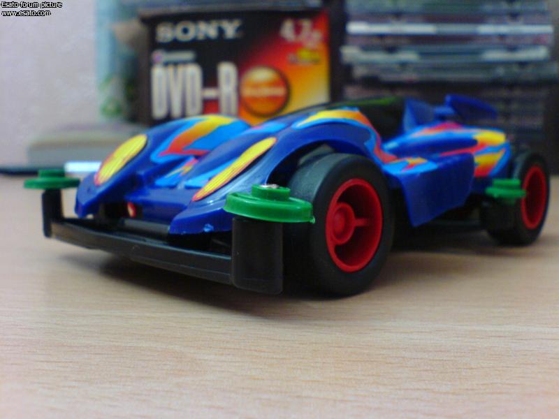

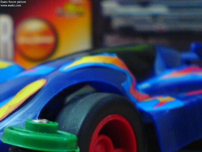

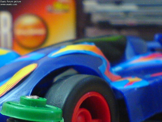

Hi ^_^
back with a question
I was compairing sarmad ,raiderski,lpachuong and my driver (lastes drivers ) and I found this
compairing to the others my driver gives white dots in night shots check this
lpachuong ( sarmad and raiderski gives me same result if we talk about the noise because of that I just upload lpachuong shot )
and here DarKMaGiCiaN
and here after crop the pics
lpachuong
DarKMaGiCiaN
is that because of the sharpness or what ??????????
[ This Message was edited by: DarKMaGiCiaN on 2007-08-31 19:08 ]

On 2007-08-31 19:55:40, DarKMaGiCiaN wrote:
Hi ^_^
lpachuong
DarKMaGiCiaN
That is interesting. I think it is about the sharpness. As you can see the sharpness on my driver is too high on cid49 and ur is 5 which is standard. Maybe your theory is true. You can test it with this driver if u have time, my friend: http://www.mediafire.com/?d0l4bhkmedf (careful with the compression) If this one give white points the ur are right.
[ This Message was edited by: lpachuong on 2007-08-31 19:38 ]

DarKMaGiCiaN
make sure that image filtering is enabled in night mode. this looks like chroma noise. i remember this from my pictures when filtering was disabled during night mode

@lpachuong
I test the driver but nothing new mmmm (careful with the compression) camera keep crashing :$
@Raiderski
I made two drives one with image filtering and the other is without
and I got the dots in both of them
thanks for your help friends ^_^
