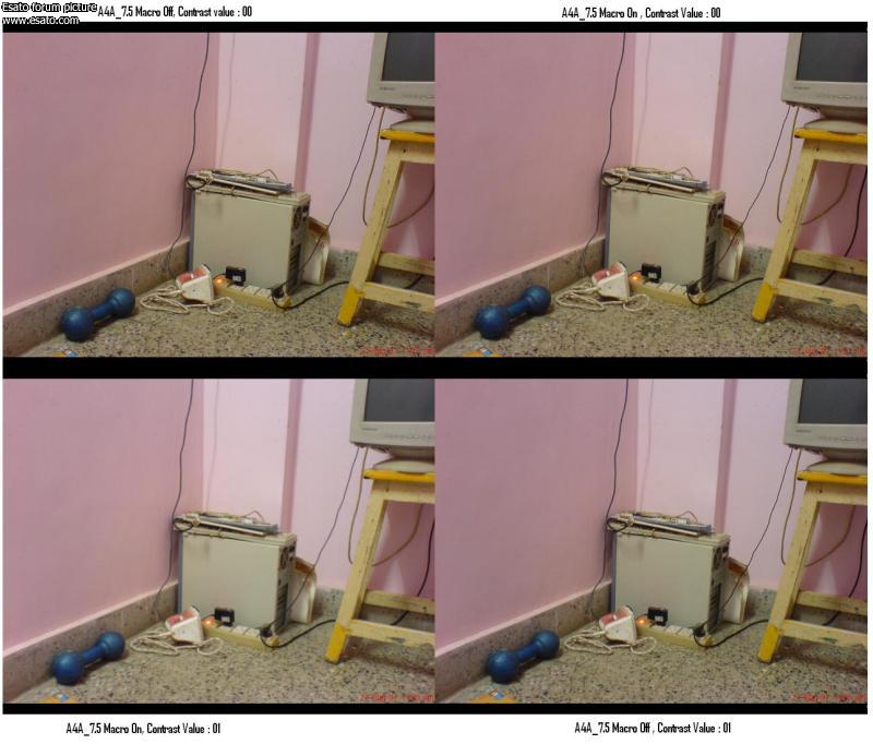

JeganathanK Joined: Nov 16, 2006 Posts: 8 From: Pune,India PM |
@lpachoung and Raiderski
Thanks for the instruction...
Here is the comparision of Raiderski 6.5 T5 With macr and Without Macro..
W800i,R1BC002,CID36
Here is the comparision of A4A 7.5 driver with and with out macro in different contrast value..
This is comparision of A4A_7.5 with LED and Without LED
Conclusion:
A4A_7.5 with Contrast 01 with macro off is clear and actual color value..
A4A_7.5 with Contrast 00 With and Without Macro -- More yellowish..
Raiderski 6.5 T5 -- if you see in the wall some dots are coming and it is less sharper than A4A_7.5 driver(in my eyes )

Power_VANO Joined: Jun 02, 2007 Posts: 144 From: Georgia PM, WWW
JeganathanK
You make a big mistake. in Raiderski's driver, macro on is not enhanced mode. When you unable Macro mode, macro range (10-40 cm) is turned on, so camera wont focus correctly longer than 40 cm. You must turn macro off to focus to that range.
and if you want to unable enhanced mode in Raiderski's driver, set EV at +0.7 and set then set Zoom to 1.1.

JeganathanK: Of course, look at manual (btw. run, till raiderski will come, or he would kill you:)) How does Power_VANO said, macro in 6.5 is for only short range, but if you don't like it, it nothing easier to open camdriver in a text editor and change (I guess) AF_SCAN_MODE= $s0 01 into 0 00.
ljcii: Beta 8 is last version of hybrid driver, not 5.8. I hope, 5.8 is only "one".
Aaand..well, maybe you could'n post so much big photos, if it isn't really important (direct comparsion, big mistakes...), but just thumbnails and links.... It's a big chaotic for me and time longer time to load the page:)
