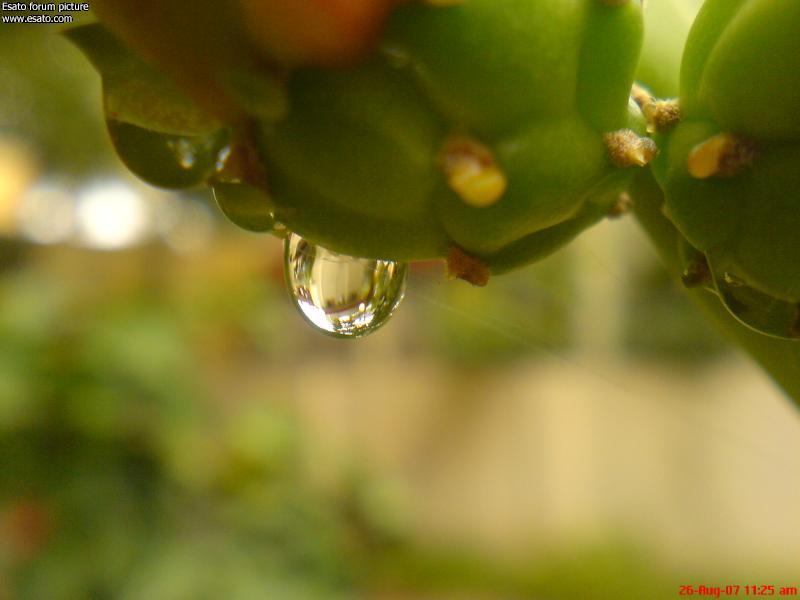

radicalgel Joined: Oct 06, 2006 Posts: 98 PM, WWW
eXtreme mAcRo™! Any guesses how I got so close?
Dead Cactus flower: ~1.2cm in diameter!
Drop of water: ~0.5cm wide!
Very small flower: ~2.5cm
Tiny ants on a wierd plant. Ants were ~2mm = ~0.2cm long!
A little caterpillar. ~0.5cm thick!
http://www.flickr.com/photos/radicalgel/
[ This Message was edited by: radicalgel on 2007-08-27 04:38 ] |
lpachuong Joined: Jun 06, 2007 Posts: > 500 From: Vietnam PM |
WoW. Nice pictures. Could you please send the original pictures for us? Thanks
f@y$t() Joined: Aug 20, 2007 Posts: 7 PM, WWW
On 2007-08-26 19:50:56, radicalgel wrote:
eXtreme mAcRo!  Any guesses how I got so close?
how do you do it?!
can load origindl photos? |

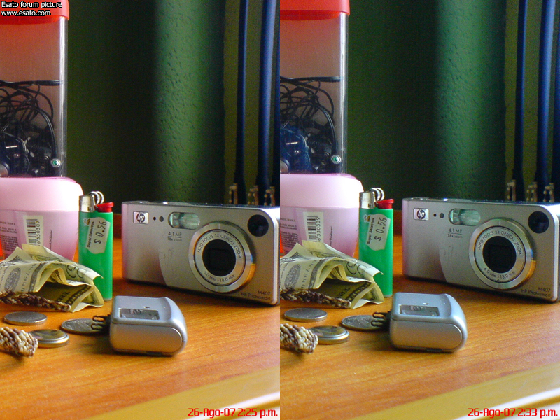

chiliseo Joined: Jul 19, 2007 Posts: 66 From: El Salvador PM, WWW
Light conditions not good...as you can see
This is the test
First test: A4A 7.5(left) Vs A4A 7.6(right)
The differences on contrast is visible. I prefer the left one
The right one has more pink color. I don't like that
Second test: A4A 7.5 (left) vs. Raider 6.5 T5
What I see is: the right one is darker (on shadow areas) and the left one has more vivid colors, even when contrast=00 and saturation=06 on both drivers.
So lpachoung please continue the development of your driver for cid36 based on 7.5 version. Great work!
[ This Message was edited by: chiliseo on 2007-08-26 22:47 ]
[ This Message was edited by: chiliseo on 2007-08-27 03:02 ] |
