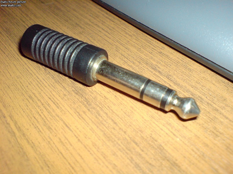

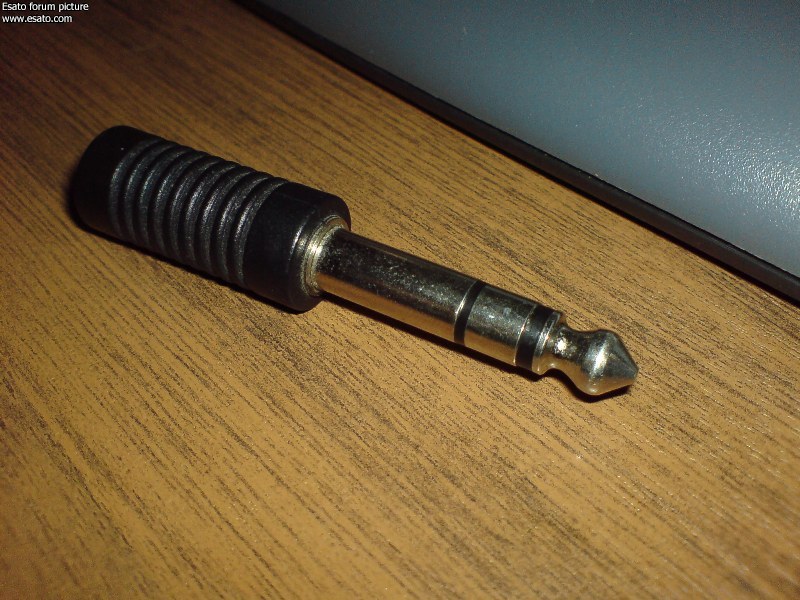

milan, why do you always use document mode when taking macro pictures instead of just turning macro on in normal mode? |
milan91 Joined: Jun 04, 2006 Posts: > 500 From: Europe PM |
Because, for me, document mode is better for macro pics
Look difference, both pics with Kop 3.3
1. document mode, with auto balance
2. auto mode, with macro, and auto balance
[ This Message was edited by: milan91 on 2007-09-16 15:48 ] |
opexblue Joined: Jan 18, 2006 Posts: 226 From: Manado, North Celebes, INA. PM |
Document Mode use ISO 100
Normal Mode use ISO 400
That's why Normal Mode is Brighter for macro pictures. |
One major difference between document and macro in normal mode is that the AF led lights, and that in document it doesn't. Looks like this confuses the phone when it AFs because the orange light gets reflected (and it will get a stronger reflection in your audio jack converter since it is shiny). If we could find a way to turn off the AF led in normal mode... I tried doing that once, but then the phone camera crashed when I tried taking a picture. But I'm pretty sure it's possible to turn off the light though. I just didn't try enough.
Or even better, we need manual focus  |
Yes, but document is better macro mode, not only for shiny objects...
I understand you, but AF led is good for some situation, but its not good for macro shots...
