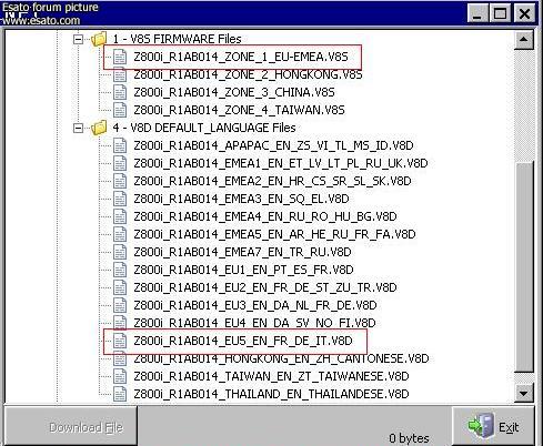

Hello everybody, I'm looking for a z800i with italian language (of course I' m italian). The phone it' s not on sale in my country, but I' ve found some on the web. The trouble is they don't come with italian language (menù, T9 ...). Does someone owns any z800i (not branded) with italian language ? If not I' ll stop looking for it.
Thanks.
Pallister
Joined: Nov 13, 2004
Posted: 2005-07-15 15:35
Italian language files are available, so that shouldn`t be any problem. You just need to get the phone flashed with the language pack you desire

Yes, pallister is correct. The language pack is EU5. Here is a screenshot of what files to use.

Correct. The EU5 has German, English, French and ITALIANO
