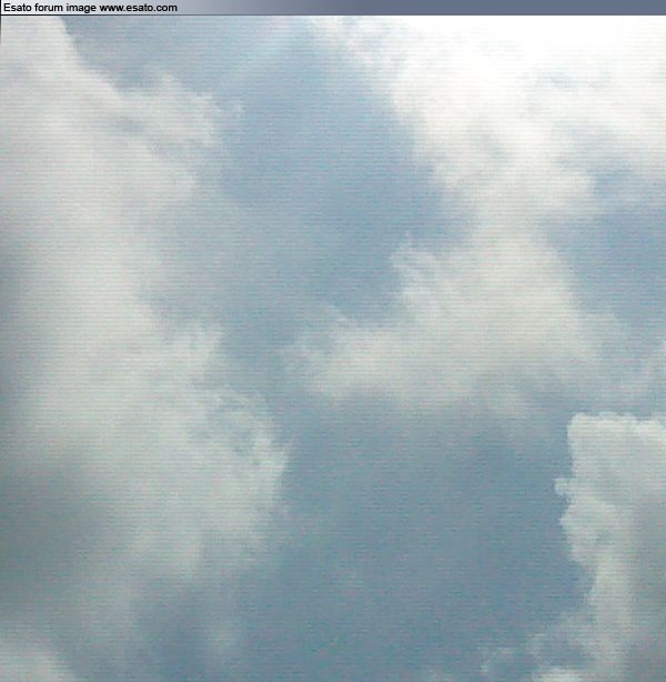

Hi, I've been testing out your drivers on my G705 today, it's pretty nice, but I noticed this minor problem:
There's some scanline-like effect on bright objects (in this case, the sky), wonder why this happens?
Also, is it possible to reduce/turn off the noise reduction for the drivers?
EDIT: noticed that photoshop removed the exif for the photo, the exif says that it's taken with f/2.8, 1/6400 sec, iso 10, -0.3ev
[ This Message was edited by: Aclaw on 2009-06-17 03:32 ] |
Sometimes happens errors of synchronization, you can try to change the clock driver.
About iso for these sensors no have anyone relationship with noise or without noise in the final composition of the photos, with some photos of sampled not feel that the iso influence but the luminosity yes.
You can try change the iso for works in auto iso 10 to iso 8000.
