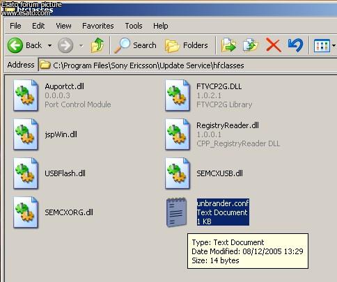

trevorc
Joined: Dec 07, 2005
Posts: 8
Posted: 2005-12-08 14:41
Ive become totaly obsessed with achieving this now Doc..!
this is what I have in the hfclasses folder.
as you can see the unbrander.conf file is 14bytes etc
Ive tried about 4 times this morning using the recovery mode without success..... and its still has 162006/5 as the cda.
Something that is strange is, when the update is complete, it's only reaches 88% and says its finished.?!
As a last resort, can someone pls send me their SEMCX*** files PLUS the unbrander.conf file ????
Thanks in advance..
TC
[ This Message was edited by: trevorc on 2005-12-08 13:43 ]
Scorpian
Joined: Jan 21, 2005
Posts: 53
Posted: 2005-12-08 16:48
Looks like your unbrander.conf file is named
unbrander.conf.txt
trevorc
Posts: 8
Posted: 2005-12-08 17:01
Cheers Scorpian, I used wordpad to change and add the CDA**** info. WHich prog should I be using ????????? How can I confirm if there is the extra 'unwanted' .txt ????
Cycovision
Joined: Nov 30, 2003
From: England
Posted: 2005-12-08 17:05
Use Notepad instead of wordpad, and when you click 'save as', make sure that the drop down box for 'file type' in the save window is set to 'all files' and not 'text files'
