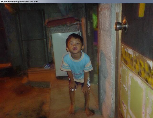

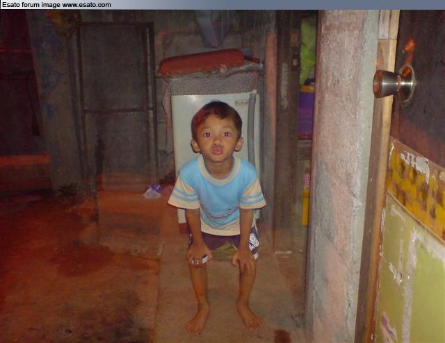

i have question...why is that when i take pic at twilight portrait the light become orange???here are some samples...
2.99.9 se2
2.6 withan
|no phone to mod| |i my k800|

the k800i's flicker correction only updates when you open the camera shutter i tried to make it update more but i don't think it worked, you must open the camera shutter in the same place & under the same lighting conditions your gonna shoot the pic in.

On 2008-04-14 15:11:28, bryanjay420 wrote:
@number1
2.99.9 se2
2.6 withan
It should be because of JPEG buffers or JPEG compression or "slow sync"...
Have you tryed to make it with some of Goldmixes....?
JPEG settings are just JPEG settings they don't control colours or anything if the flash was used then yes it was the 1/2 sec shutter speed my twlight portrait mode has.

i dont know...its just when i took pics at a not so good light condition the light become orange...specially with 2.99.9 se2...in withan 2.6 no problem coz i know i can make some special effects with it and the light is not very orange...

@number1
Have you noticed difference between your settings of 2.99 and some of your next or previous camdrivers...
Try to change whole property 5 only,nothing else...
Also you can try to set default JPEG buffers...

On 2008-04-14 16:15:10, Goldmen wrote:
@number1
[ This Message was edited by: Goldmen on 2008-04-14 15:19 ]
Jpeg are just jpeg settings they control nothing else, i'm pretty sure i had this argument with raiderski once but the other way round, but anyway he was correct jpeg settings are just jpegs settings nothing more they don't control exposure colour or anything, i don't have a problem with orange lights but i know how the flicker correction works and that it only updates once the second the lens cover is opened, so point the camera at the orange light then open the lens cover, then take the pic and the flicker correction will be correct, whats needed is manual flicker correction like some nokia's have.

Posted: 2008-04-14 16:28
May be I`m wrong...
But you can test my suggestion,I think...
...and don`t think I want teach you how to make camdrivers...
Also red colour could be because of flash color temperature...
Am I right...?

maybe colour flash temp but bryanjay420 never said if the flash was used, i corrected the flash temps in 2.99.9 SE2 not so long ago because the flash pics were a bit red.

On 2008-04-14 16:46:34, bryanjay420 wrote:
whats the setting you use for twilight modes?tungsten??i think maybe thats the case...
In some cases it`s better to use tungsten WB...

yup...i also think that situation where in ultimate when focusing the screen goes blueish...thats the default wb for twilight mode for ultimate...maybe it reduces orange light a lil bit....
