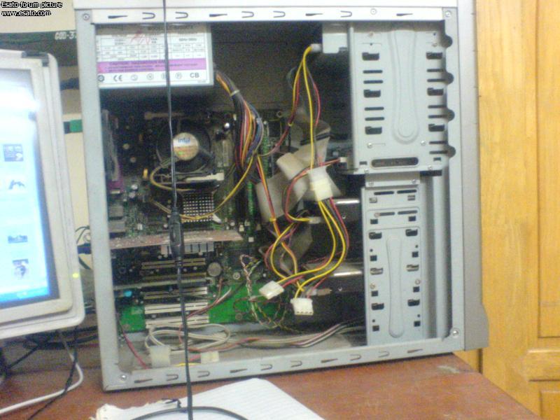

Posted: 2007-08-08 10:35
well dis is frm 6.4
is anything wrong wid my setting..y dis pic luk dullish type..i m saying so cuz i can compare wid d actual colors of my cpu
newaz..suggest

Posted: 2007-08-08 10:40
terminator17
enable enchanced mode - EV +0.7, zoom 1.1, look into readme.txt for more info about this
