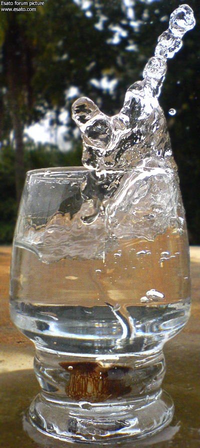

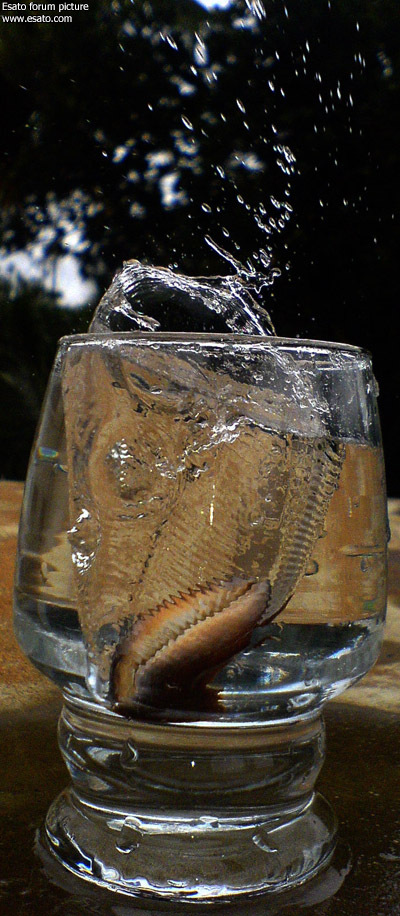

Couple more shots with SPU 1.3 b9. These are high shutter speed shots 1/5000 to freeze the splash caused by dropping a shell into a glass of water!
Not enough sunlight so the pics aren't as good as I wanted them to be but i like them anyway. Will try to get a better shot when I get a good bright day!
