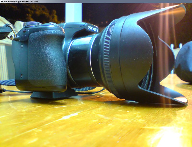

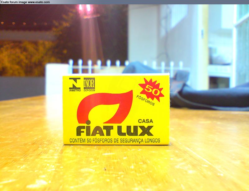

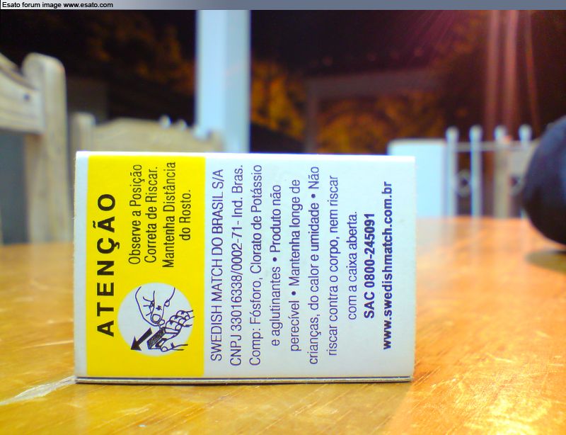

The new concept in an attempt to use all functions for this models k850/c905/c902/c903/w902/w995.
Basically will be supported on the same basis and with all functions available for these sensors, Of course every model is within the limitation but apparently all the functions ok.
Any ideas, suggestions, opinions can discuss together to enjoy the ability of each model.Any idea guys!
sample pics:
manual shutter speed slow/fast 1/640s
+manual iso 100
+manual contrast
+manual focus
+manual contrast
+manual brigthness
manual shutter speed slow/fast 1/125s
+manual iso 100
+manual colors correction
+manual saturation
+manual focus
manual shutter speed slow/fast 1/1600s
+manual iso 100
+manual sharpness
+manual hue
manual shutter speed xenon flash avaliable the same schemma of the other version.
