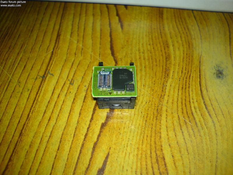

amarsidhu
Joined: Mar 09, 2004
Posts: 361
Posted: 2007-07-24 15:49
can we put k750 CID 36 cam module in W810i??????
is this possible???? [addsig]
Posted: 2007-07-24 15:54
i think it can be done. someone changed a camera module from a CID49 k750 to a CID36 k750 and i guess that you would be able to take pics at ISO-80.
here: CID49 camera against CID36 camera - what Differences?
40% online
and i got the other half
[ This Message was edited by: tranced on 2007-07-24 14:59 ]
pakraider
W715 Black
Joined: Jul 25, 2003
Posts: 313
Posted: 2007-07-24 16:37
interesting.... well the W810's camera module lets you take pics at ISO 80.. but from sample pictures, the k750 CID36 module still looks to be better. it would be a major find if someone could retrofit it into the W810.
moved on to the Nexus One.. needs a better Android
amarsidhu
Posts: 361
Posted: 2007-07-24 16:47
i have a CID 36, K750 Cam Module. and i want to replace it in my W810.
Will the camera flex fit in????
I need some suggestion before opening my w810.... huh..... [addsig]
amarsidhu
Posts: 361
Posted: 2007-07-24 17:47
finally i have changed the w810 cam module with old k750i CID36 cam module
and its working fine.
fitting is exactly same.
i will test it now to see the differences. [addsig]
amarsidhu
Posts: 361
Posted: 2007-07-24 17:50
this is w810 cam module
this is an exact fit. hurrrrreeeeeeeeeeeey.
