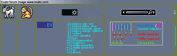

Download:
http://www.4shared.com/file/5[....]d_j0maTeiXaPietropizzitar.html
