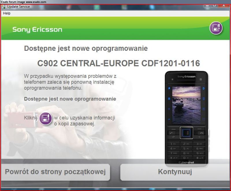

0kti Joined: Dec 24, 2006 Posts: 290 From: Poland PM, WWW
oh my god! shocker !!!
seus shows there is new firmware for cdf 1201-0116
now i have r3ea037 but i must go to work and i don't have time to update
Please somebody test it!!
Samsung Omnia 8GB + 8GB MicroSD |
On 2009-04-17 05:47:59, tranced wrote:
is it for western europe?
i'll see if there's any for my c702
Central europe
